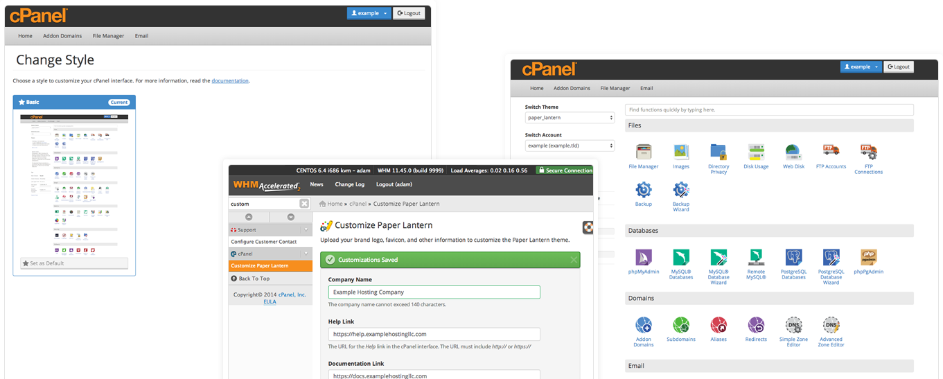

I totally dislike that toy looking interface, like it was designed in the 90's by a teenager
Have you try they new paper lantern themes?
Torgut
I have to admit that looks awesome, but still, in terms of user friendliness (the logics of where something will be found) my heart is with Plesk... for almost a decade now.
