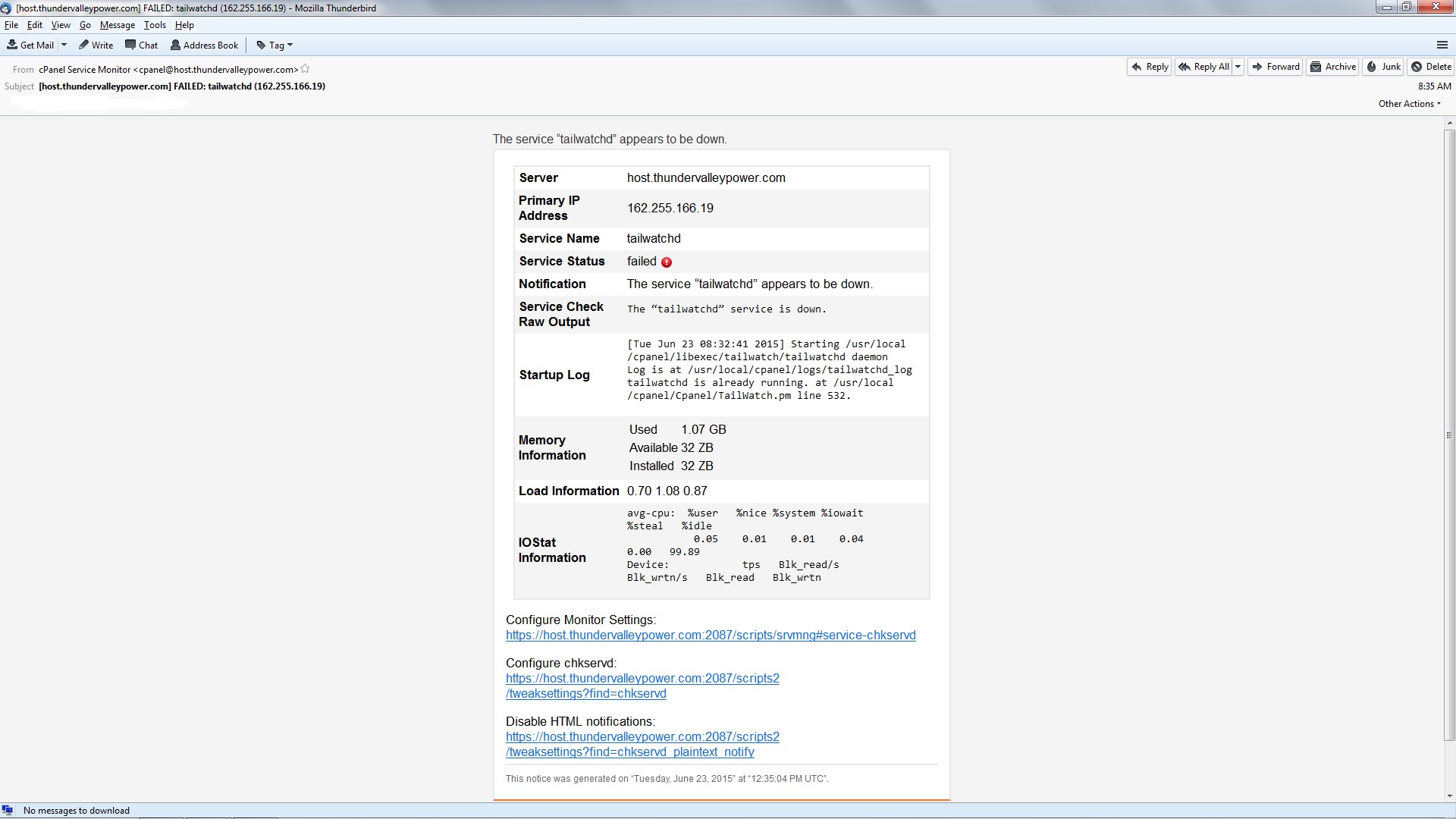

This morning I got an email with the message: The service “tailwatchd” appears to be down.
It looks like it was sent shortly after cpanel was updated to 11.50.0.19.
Was this a one time thing or do I need to be doing something?

It is running, and the Startup Log (image in the original post) indicates that it was already running, but with a different path. Anything I should look at there?
Nah I'd say it looks like the path changed with the update is all then.
If you continue to get errors then look more deeply into it but if it's a one off thing then I wouldn't sweat it.
