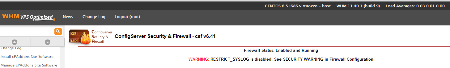

CSF v6.41 now seeing: WARNING: RESTRICT_SYSLOG is disabled. See SECURITY WARNING in F
unknownhost
What is appropriate course of action for this?
Have not knowingly changed anything ...running as vps cam out of the box
ConfigServer Security & Firewall - csf v6.41
Firewall Status: Enabled and Running
WARNING: RESTRICT_SYSLOG is disabled. See SECURITY WARNING in Firewall Configuration
unknownhost
Reading more I see the attached below, What is recommended setting?:

KH-Mathew
Systems Administration
Hi,
Since the logs would be modified by writing the the syslog socket, and not the flat files themselves, the possible vulnerability is that a user could add data to syslog which could be interpreted by CSF/LFD, but I don't see how this would allow them to modify what is written by other processes. This means that while you could have some spoof lines entered into log files users could not do something like remove login failures from /var/log/secure to allow themselves unlimited tries at bruteforcing the root account, or anything along those lines. It would be possible for someone to add some misleading information to logs like /var/log/messages, /var/log/secure/, etc (intended to be read literally, not as the directory /etc), but not remove pertinent information in these logs. I would leave this at "0" as having the chance of the log being less than 100% reliable is better than no logging at all in my opinion. If someone does write arbitrary data to any of these logs via syslogd then you will know that it is a user with an account on the machine and a process that is running under their UID, which might make it easier to find. I have never seen anyone exploit this myself.
VPS hosting solutions from US company KnownHost - The US VPS Experts.
unknownhost
Thanks. That is what i read, with my limited comprehension, into that myself.
I imagine how this error is presented, that this could result in numerous support tickets.
KH-Mathew
True, that does look alarming at first glance. I think it is great that they are making their warnings catch the eye though. It will make users aware of something that may be of some use to understand in the future. Keep on using up the forums anytime you have a concern like this though. Hopefully it will explain the same warning to other users.
