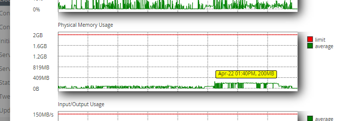

I have CloudLinux installed on a Cloud VPS-4(12GB RAM) and I have a website that seems to hit some weird memory limit that is only 200MB. Even If I've setup memory limit to 4GB, it will not go over 200MB. Anyone have seen this issue? You can see that memory was in a straight line for many hours @ 200MB

I saw 256MB limit in the Wordpress config file and it's a bit over the 200MB peak I saw in LVE Statistics. Maybe in LiteSpeed Memory soft limit for(2048M). The "M" doesn't seem to be working as expected maybe. Since the hard limit is also at 2048M, I'll try to raise it to 3072M.
