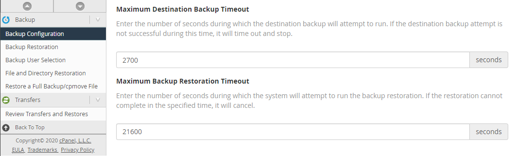

Here's where those settings that JonathanKW mentioned are located:

The Maximum destination backup timeout was at the default setting, I think it was 2700 which is 45 minutes. I have now changed it to 6 hours.

There's another timeout under the remote destination configuration too, you may want to check it as well.
That timeout is set to 30 seconds and has a maximum of 300, it looks like it's just looking for a response from the remote server and is not a transfer timeout.
Timeout
The number of seconds that the system will wait for a response from the remote server.
I'm not seeing any of the text from your log file snippet at all in my log. No 'LoggerAdapter' or 'warn' or anything similar to that. There are no failures or warnings in any log at all that I can find.
